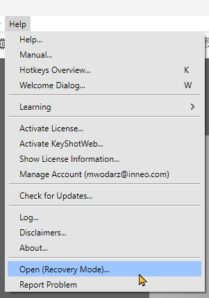

For cases like this, you can use open in revovery mode. This would load the scene but doesn’t execute the geometry shaders. These could then be caulated easily by each material.
It works again! Thanks so much :heart_eyes:
